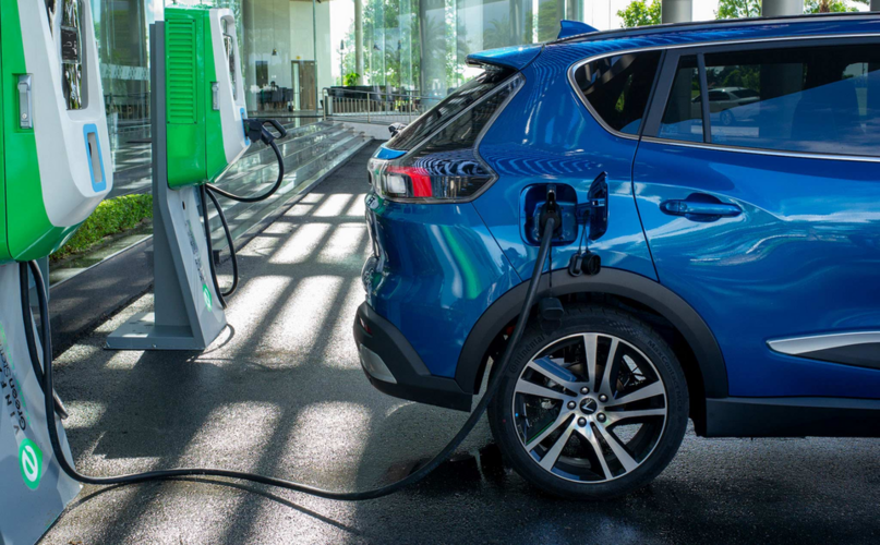

![1721983566403.png 1721983566403.png](https://vnrv.s3.hn-1.cloud.cmctelecom.vn/data/attachments/12/12563-b338fcaa95727918d3510f78c4cca8e6.jpg)
